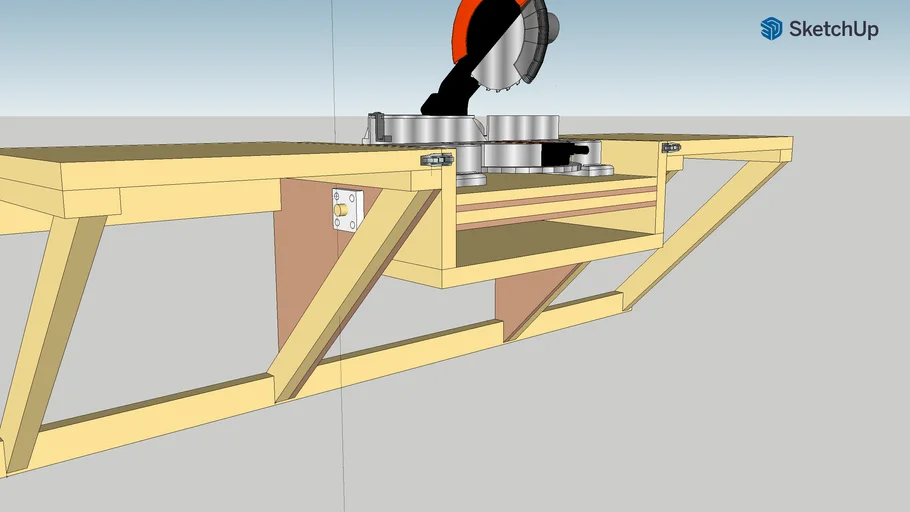

Wall-Mount Flip-Top Miter Saw Station. Much consideration taken into fitting a variety of 12" non-sliding saws (using different amounts of shim material underneath). Inspiration taken from Casual DIY's flip top design (https://www.youtube.com/watch?v=P68NqMmUDeM&t=558s), pay special attention to the adjustable pipe mount at this timestamp. Inspiration also taken from Woodsmith's wall-mounted workbench design. This serves as an outfeed for a bandsaw and infeed for a planer, so it needed to be an EXACT height. Wall mount works best for this, rather than trying to figure out a bunch of math and matching up specific casters, etc: just hang it where it needs to be, and independent of a pourly poored garage floor. Also leaves more room underneath for air compressor, vacuum, etc.
