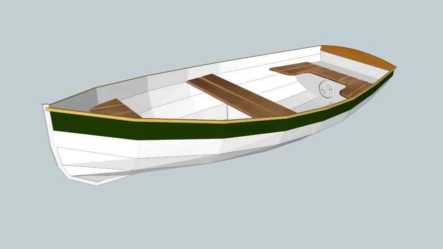

This is the boat I designed for myself, a 3.3m sailing or rowing dinghy. It has to be further modelled - fited with either oar locks or mast & sail and a rudder or both. Dagger board case should be fitted to the front of the center rowers bench and mast should be nested on the floor just after the front flotation chamber and a hole shall be made for it in the front deck center layer plank. Standing lugger sail of around 5-7 sq.m will do. It has two flotation chambers in the bow and in the aft. Should be suitable for 3-4 people. Construction can be made in stitch&glue plywood method. #boat #dinghy #lake #marine #maritime #naval #navy #oar #plywood #row #rowboat #sailboat #sea #water #łódka #łódź #żaglówka
