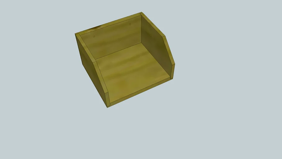

A basic plywood shelf for holding drill bit sets. 9-3/4" deep x 11" wide bottom, 6" deep x 11" wide back, 9-1/2" wide x 5-3/4" tall sides with a 45 degree angle cut. This is meant to mount behind, and above the top of a drill press being used between garage doors. Construction is rabbets, glue, and screws. #Drill_Press_Accessories #Garage_Workshop #Plywood #Shop_Fixtures #Woodworking
