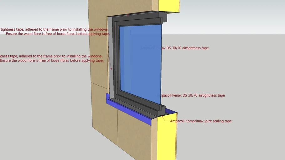

The second step is to install the window. Prior to installing, apply the Ampacoll Fenax DS 30/70 airtightness tape to the outside of the frame, as shown. Zoom in to see how it is installed. Once the window is fixed in place, the Ampacoll Fenax tape can be adhered to the perimeter of the opening to ensure air and weather tightness.
