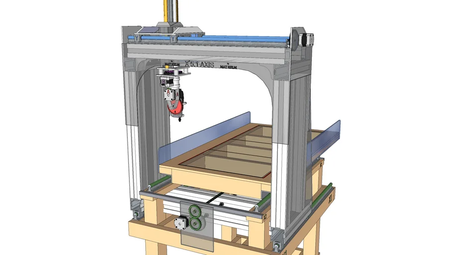

Measurements are in Imperial. The groups are setup for moving all 5 axis in the order of X1~X2,Y,Z, B then A.
The "table Height is 24" and can of course be lowered if needed.
Work area (movement) is 10.25" Z axis, 21.5" Y axis and 48" X axis.
My idea of a DIY 5 axis CNC with a double slide on the X axis. Tell me what you think, and feel free to alter, but please share with me your improvements.
All hate free comments and criticisms welcomed...
