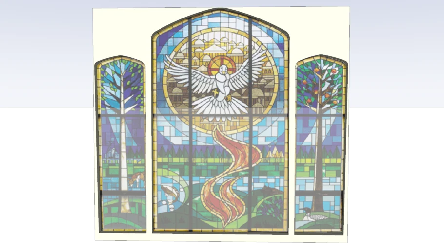

Stained Glass Window for Will. (See forum thread below - for some reason the original, "long" url does not appera). The basic concept is to trace the outlines of the window and Push/Pull the "wall" part into thickness while leaving the "window" to be a single plane. Give some transparency to the window - but note that 70%! opacity will cause it to cast a solid shadow while less than 70% will cause it NOT to cast shadow at all; so there are no nice, coloured light patches on the inside floor with the sun shining through. #Gaieus #Glass #Stained #Window
