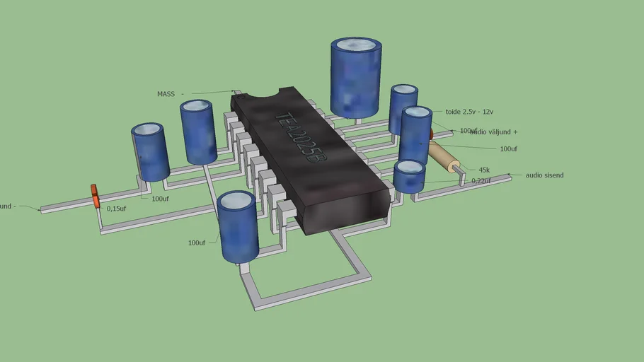

a small audio amplifier that contains less components than usually amplifiers do. It is a mono amplifier and is rated originally 5x5w, this one is bridged so it has 10w of rms power, witch is good for some tweeters or a portable speaker project. It works with 2.5v up to 12v, so you can run it off of a 1S lipo or one 18650 battery.
