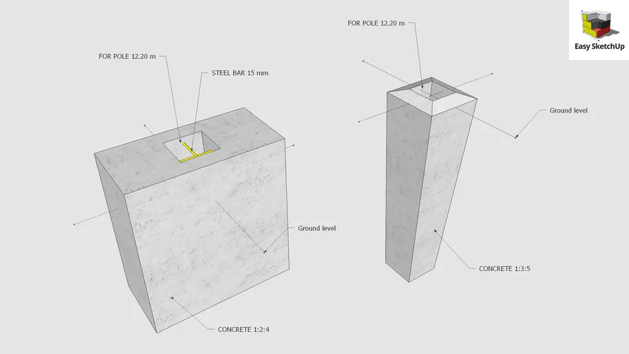

POLE FOUNDATION AT TRANSFORMER ON PLATFORM 3000 kgs
Easy Sketchup
Maximum allowable working load not exceed 3,000 kgs 1.For poor and normal soil condition(marchy soil, clay and sandy clay) using concrete 1:2:4 and steel bar 15 mm 2.For good soil condition(sandy soil and lateritic soil) using concrete 1:3:5
