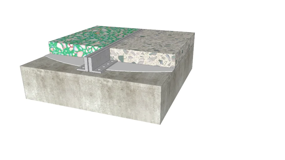

This detail shows a polyacrylate terrazzo floor finish meeting an epoxy terrazzo floor finish with both finishes installed over a concrete substrate. Back-to-back L divider strips separate the two terrazzo finishes. The person using this detail shall be responsible for its complete design and proper application.
