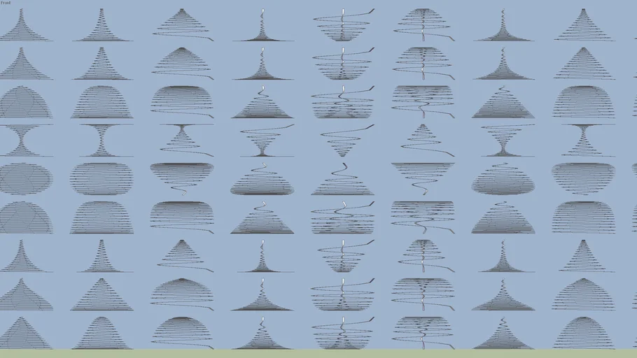

A 1/2" edge revolved about the Z-axis while increasing the radius to 10" and falling 10" in Z - The deltaR and deltaZ interpolations are each independently varied using linear, sine, arc1, arc2, arc3, arc4, log10, parabolic, and cubic transforms (81 combinations in all). #helix #mesh #spiral #spirix #surface
