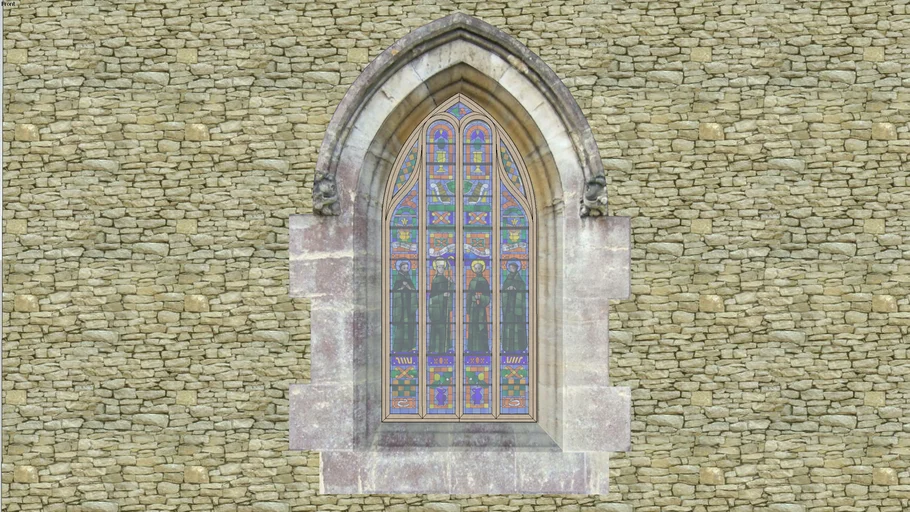

This is a Gothic window with some simple tracery and stained glass. It is made up of a bunch of subcomponents. Currently it is set to "glue to any" and "cut opening" but of course it only works on a single face in SketchUp. If you explode it however, it will retain its cutting feature on the front and the nested component on the back will regain its own - i.e. it will cut a hole on both sides of a thick wall. Only explode it when you are sure you do not want to move it up and down any longer. Note that currently it is set to cut a wall of 120 cm (~4') so if you want to get it to cut a different wall thickness, scale the window component first. It's also "Twilight ready" and there is a layer for a thin, realistic glass > common and the same with a 1cm thickness. #cut_opening #Gaieus #glue #Gothic_window #stained_glass #tracery #twilight_render
