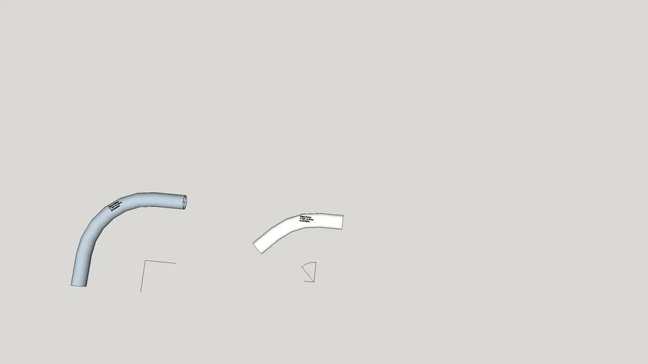

Two (2) 2" EMT Elbows from Sigma Electric sold by Menards stores in USA. As shown and drawn from Page 26 of the Sigma Electric catalog: https://sigmaelectric.com/sites/default/files/Retail%20catalog%202018.pdf The info for the 45-degree Elbow shows OD of 2.00" which is way out-of-spec for standard 2" EMT of 2.197" (55.8mm) nominal. I drew both elbows to spec size with 0.065" (1.65mm) nominal wall thickness. https://steeltubeinstitute.org/steel-conduit/types-of-steel-conduit/electrical-metallic-tubing-emt/ 90 Degree
