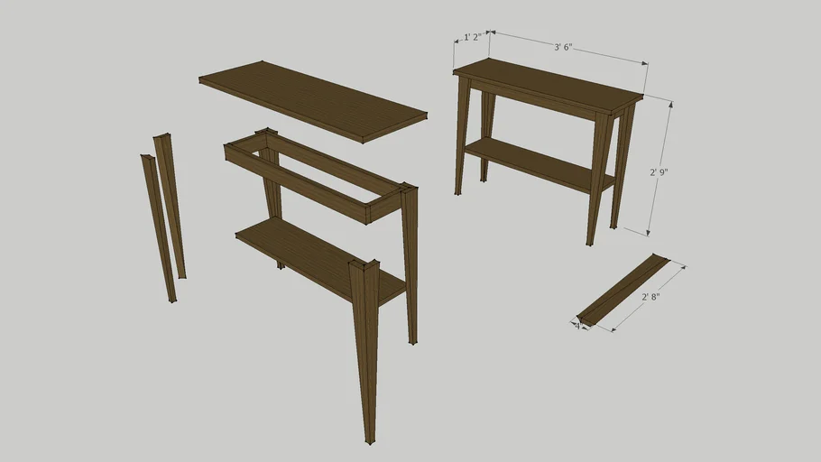

This is a console table I plan to make. I've designed it knowing that I will be constructing it out of 1x4 or 1x6 dimensional lumber from a local lumber yard (so the legs need to be made of two pieces and mitered together. This will match a future dining room table which has metal hairpin legs. The first view shows a semi-exploded, the second shows the massing / scale of the piece next to the stairs. #3D_Challenge_158 #console_table #furniture
