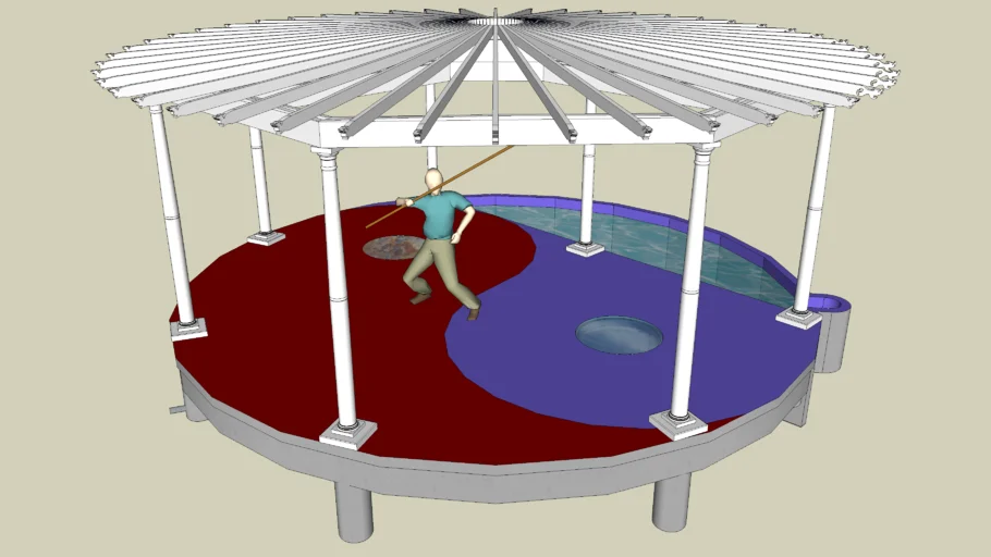

This is a proposed design for my yard. The diameter of the pavilion is 25 feet. The rear is a koi pond approximately, 6 feet wide, 20 feet long, by 4 feet deep; having a volume of approximately 17,000 gallons. A goldfish tank with a 1 inch thick tempered glass cover is set into the floor of the Yin side. It has standard 6 inch figerglass Tuscan columns supported by 2 inch heavy-wall pipe set into 3 foot deep footings. One of the footings is penetrated by the support pipe to accomodate electrical wiring to the roof. The roof has a 4 degree slope with spacers set over the beams to keep the beam ends level all the way around. The beam ends are cut with Chinese imperial dragons on the Yang side, and water dragons on the Yin side. The pond is intended to have an external filter/pump well feeding a waterfall bio filter behind the pond. #Califorinia #Chinese #Chinese_garden #column #koi #koi_pond #pavilion #pergola #pond #San_Diego #Tuscan #Tuscan_column #USA
