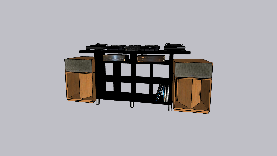

In 2021, I wanted to build a new DJ booth. After looking online and seeing several others using IKEA parts/components to build one, I decided to build mine in SketchUp first to ensure it would fit all of my gear and have the appropriate dimensions to fit the room I was planning on putting it. All IKEA parts are exact dimensions at the time of purchase/assembly and can be found here: CAPITA legs here: https://www.ikea.com/us/en/p/capita-leg-stainless-steel-60263574/ KALLAX cubes here: https://www.ikea.com/us/en/p/kallax-shelf-unit-black-brown-20275885/ LAGKAPTEN top here: https://www.ikea.com/us/en/p/lagkapten-tabletop-black-brown-60487017/ To elevate the LAGKAPTEN above the KALLAX, I used 3 2x6x15 pieces of treated lumber and painted them black. Finally, I used standard countertop brackets to secure everything together which completed the project :D
