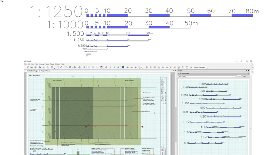

I have used these scale bars to create a custom scrap book page in LAYOUT. The scrap book page features each scale bar in its own view port at its appropriate scale. These can be pulled into a layout document when required as shown in the screen shot. In LAYOUT the scale bar view port can be adjusted to hide the scale name ie 1:100; 1:10 etc. Obviously while this is done the 'Preserve Scale on Resize' box in the 'Sketchup Model' panel must be ticked. #custom scale bars#scale bars for layout#layout scale bars#layout scrap book#
