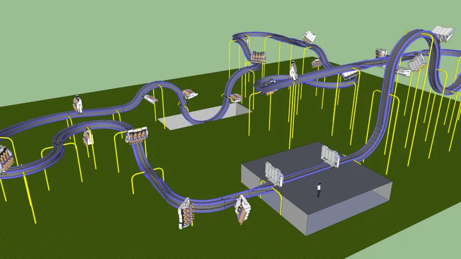

This roller coaster is based on a Mobius Strip. The track has rails on top and bottom. The vehicles ride the upper rails then do a half-twist to an inverted position on the lower rails. Because of the twist, the upper and lower rails form one long track. The vehicles do two loops on the track, passing under the station on the first loop and stopping in the station at the end of the second. This mock-up is on a Wild Mouse Coaster scale. The single car vehicles are mounted on a yolk with a vertical rotation. This keeps the riders upright when the vehicle flips to the inverted side of the track and gives it a little swing. This also means the vehicles travel backwards when inverted. #amusement_park #attraction #mobius_strip #ride #roller_coaster #theme_park
