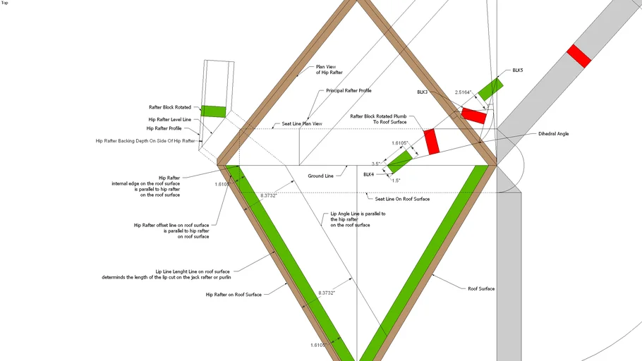

Traditional Roof Framing Geometry Layout Techniques 1
SBE Builders
Traditional Layout Basics for Hip Rafter Offset,Hip Rafter Dihedral Angle for Hip Rafter Backing Angle,Rafter Block Rotated Plumb To Roof Surface,Rafter Block Rotated Perpendicular to Hip Rafter Run Line,Rotating the Roof Surface From The Ground Line,Hip Rafter Internal Edge On Roof Surface,Hip Rafter Level Line,Hip Rafter Backing Depth,Lip Angle Line (barbe line, beard line) #framing #geometry #roof
