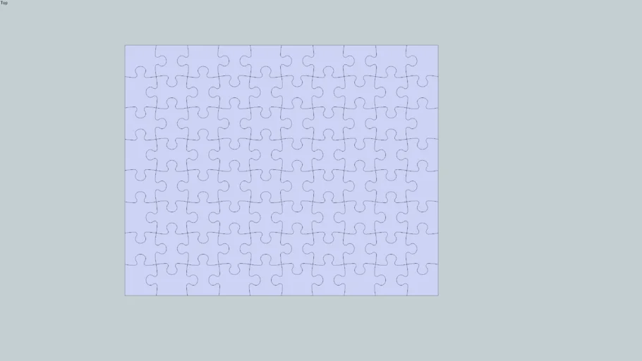

This is a 8x10 puzzle template for making jig saw puzzles. It can be modified for other sizes. It's to be used as a guide, you don't have to cut the parts right on the lines. To use: glue your picture to plywood. glue the template to plywood or cardboard. Then tape the template and backing over the picture. Cut out the parts, starting at one edge, cut the rows first. Then cut each piece apart.. That way the clear tape will hold the template to the puzzle as you cut out all the parts. Have fun! #diy #hobby #make #plywood #puzzle #saw #scroll #scrollsaw #template #wood #woodworking
