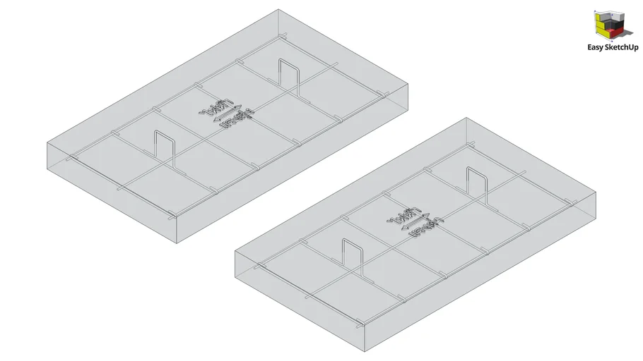

Reinforced Concrete Slab
Easy Sketchup
1. Reinforced concrete slab as shown canbe used all underground methods. 2. The width shall be designed according to dimensions as in each underground method and RB 6 mm <= @ 250 mm 3. All concrete shall have a minimum compressive strength of 180 kg/cm2 (ksc) at 28 days and max. Size aggregate shall not exceed 19 mm (3/4 inch).
