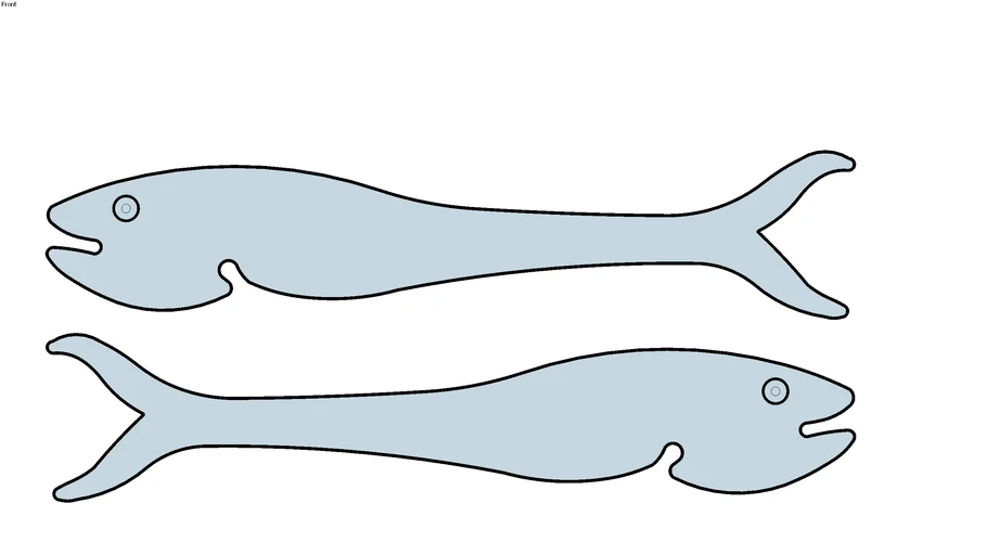

Oven Rack Push Pull Pattern
Tom F.
Cut out from ¼" mdf to make a template from the pattern and sanded till smooth. I used ½" Oak board, rough cut on band saw from template and finished with ¼" upcut spiral bit with top bearing ion router table. Attached magnets flush to back and stuck on the refrigerator for storage. template, puller, pusher, oven rack, kitchen, wood, oak
