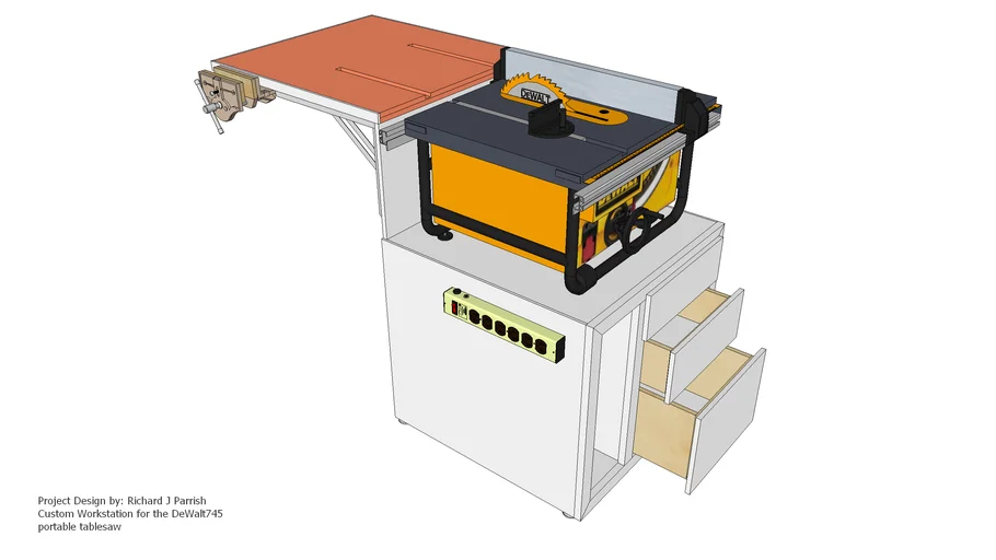

This workstation was designed specifically for the DeWalt745 10" portable table saw. The vise and multiplex surge protector were after thoughts to give possible ideas to this design. The drawers can be mounted with any hardware you desire, which is the reason I didn't include any plans regarding the mounting of the drawers. I think the 1/16" of space between the drawer fronts give this design an added professional touch. The leftside of the cabinet was designed to store the included crosscut sled plans for this table saw. Add wheels, levelers or any type of mobility and/or stability to this design that suits your needs. The cutoff table is a perfect length and mounted with 16" heavy duty shelving brackets; giving this cutoff table the added feature of saving workspace. #10_table_saw #cutoff_table #DeWalt #saving_workspace #workstation #workstation_with_cutoff_table #workstation_with_drawers
