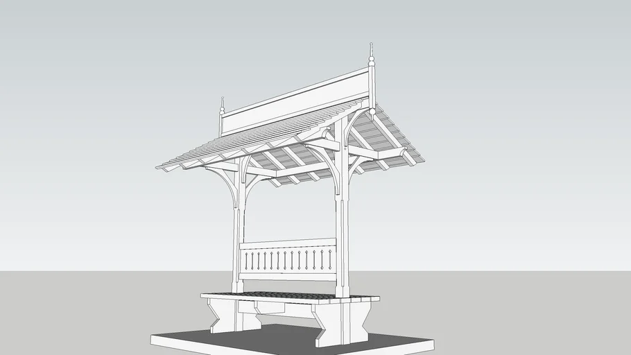

Based on two screen grabs at the start / end of "Petticoat Junction", a TV show from the 60's. This was supposed to be a railway waiting seat in the show. The design was nice so I thought I'd model it. Top panel above the roof was supposed to have the text of the station stop on it for rail passengers to read / identify / locate. Looking at the model I'd probably bolster the two main pillars to 125mm square rather than the current 100mm square - our house piles here in NZ are so sized, H5 treated (CCA), and SG10 (10 GPa / stronger than normal structural timber [SG8]).
