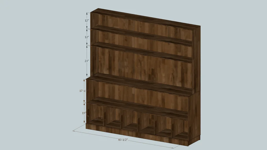

Updated design, fixed base to enable assembly, changed rendering color. 1/2 plywood, 5-6 sheets required depending on how the cuts are made. Designed as a freestanding setup, the upper hutch can be removed or excluded as required. #Bookcase #furniture #office
