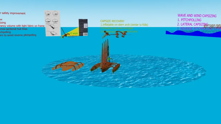

Pitchpolling
+5m masts
+Round ama bow
+Midship-stern weight
Lateral capsizing
+Asymmetric round ama
+Big hole net to avoid wind capsizing
Reverse pitchpolling
+Round stern on hull and amas
+Rear bar flotation
Capsize recovery
+sinking ama
