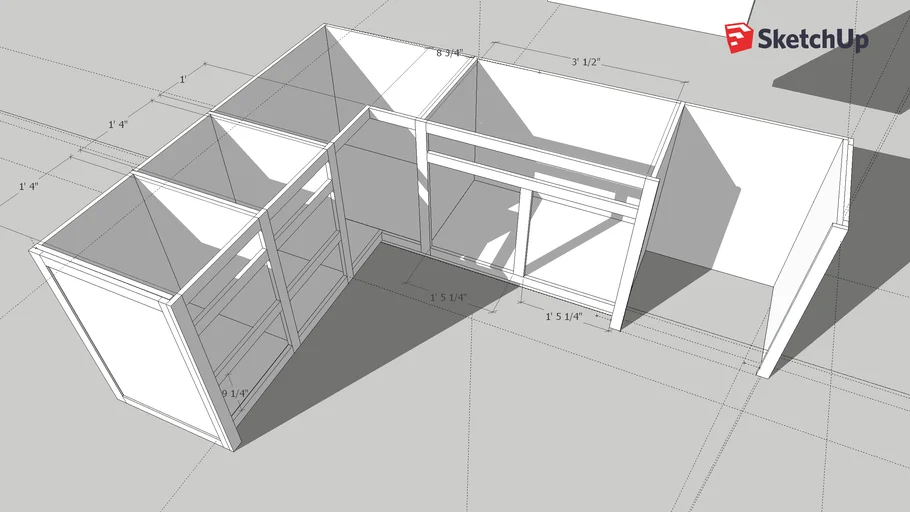

Justin C.
This is the sink cabinet using 2" stiles and rails. The plywood thickness is 0.75. This will change to 0.668-0.70 depending on what ply I end up using. The end panels will use a 1/2 material inset into the face frames for a 1/4" reveal. I built these as boxes with a separate toe kick. The floors at #1913foursquare have a lot of variation so this will make leveling the base much easier.
