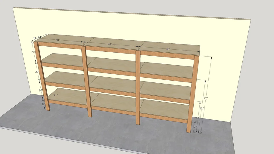

Simple garage shelves made from 2x4 and 1/2" plywood sheets. They can be made as long or short as needed. This one is 12 foot long, but any multiple of 4 can be used as that works with the plywood sizes to make cutting simple. The shelf supports are screwed to wall studs first, then the cross-braces are attached with toenails/screws, then the front shelf support and finally the upright legs on the front.
