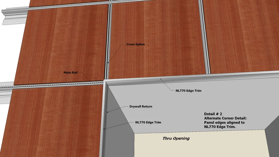

MAP System - Corner Detail @ Thru Opening, Option 2
Marlite
Surface Systems, MAP System installation where panels end at drywall soffit and returns. Typically a condition found at window, door and corridor openings. In this version the corner condition is designed to create an appearance where the panel edges align with the exposed edge of the MAP System NL770 Edge Trim. A more complex detail than Option 1, requiring a higher level of craftmanship and careful alignment during field fabrication. #corridor #door #MAP_System #Marlite #panel #panels #r_soffit #return #Surface_Systems #venee #window #wood
