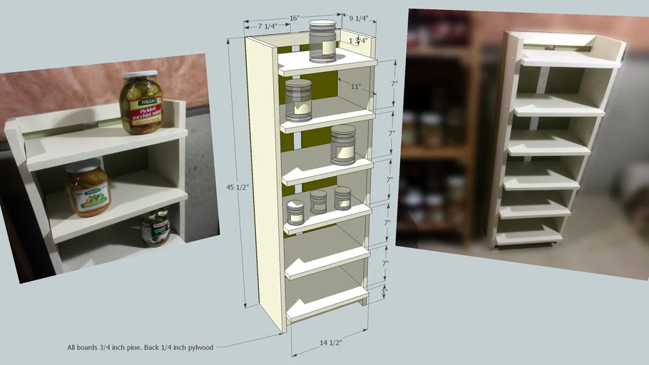

Purpose: To add shelf space for pickled jar storage in the cold room. Benefit: Store more stuff. This shelf was made with reclaimed construction wood found at local building sites. The plywood was too narrow, so I split it to provide rigidity to the shelf. Yup, some of the wood is warped. Finished with my favourite homemade chalk paint using Plaster-of-Paris. Used self-drilling wood screws for the shelves. Glued and nailed the plywood back. I just don't draw it, I build it.
