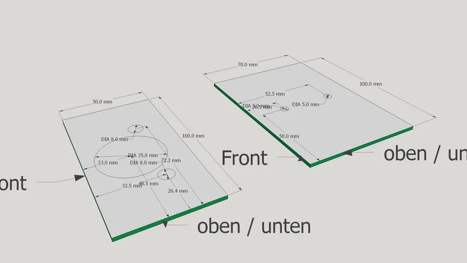

Schablone für Utrusta-Schaniere - 18mm Korpusplatten - Front vorne anlegen - oben / unten an den Boden oder den Deckel anlegen Template for Utrusta hinges - 18mm body plates - Put the front on the front - Place oben / unten to the bottom or top

    If you're using this you are probably headed for some diy work, since IKEA are so kind to drill these holes for you. The center of these to templates will eventually align to the same height. So please note that the difference of 1,5 mm from top/bottom to center of the...
    5/7/2019
    ...templates are in accordance with IKEA's cabinet doors, that are 3 mm smaller (height and width) than the according cabinet body. The doors therefore sit 1,5 mm above the bottom of the cabinet and below the top of the cabinet.
