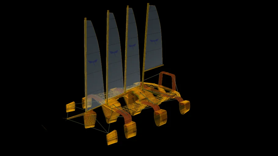

Built with recycled wood and without toxic nanoplastic Hull skin +Hemp fabric-thin veneer (0.5mm to 1.5mm) sandwich +hemp webbing Compression +Wood-steel sandwich for the akas cross-beams and some frames Tension +Amas and akas waterstays Structural loads reduction +5m masts both for less deck loads and heeling pressure on amas Safety +Multi chamber watertight bilge in hull and amas +5m masts and big holed net to avoid net heeling capsize +Capsize recovery by sinking ama and roll stern arch with inflatable similar to RIBs +Storm series drogue plates +Hull impact rails for reef protection Reverse pitchpolling mitigation +Round hull (without cockpit) and amas stern +Rear bar to improve flotation LOA: 7.65 m S.A.: 22 m² Beam: 5.80 m Displacement: 400-600kg (1 ton dragonfly 25) Max Draft: 1.50 m Min Draft: 0.30 m
