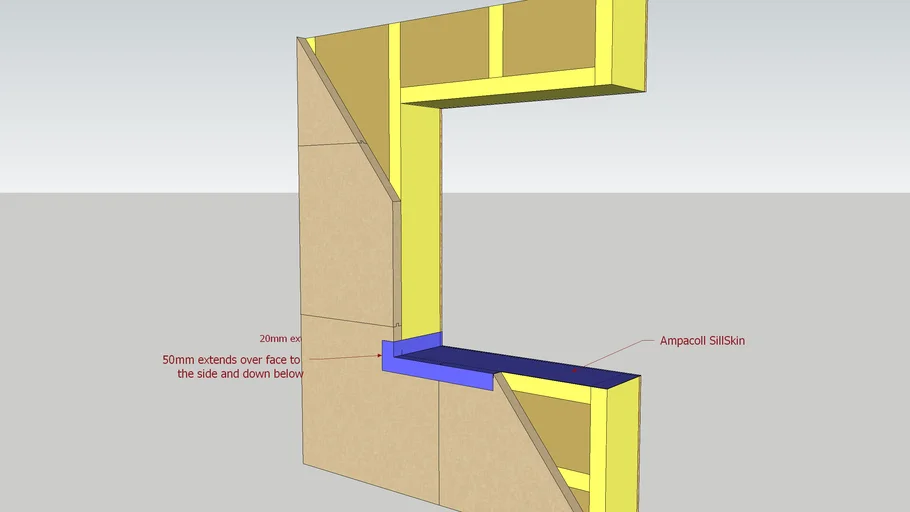

Starting with the bare timber frame and the external layer of wood fibre boards attached to the surface, the Ampacoll SillSkin is applied to the whole sill area to prevent rain ingress during the construction phase. The surface of the sill area should be primed with Ampacoll Primax Primer prior to application of the SillSkin layer.
