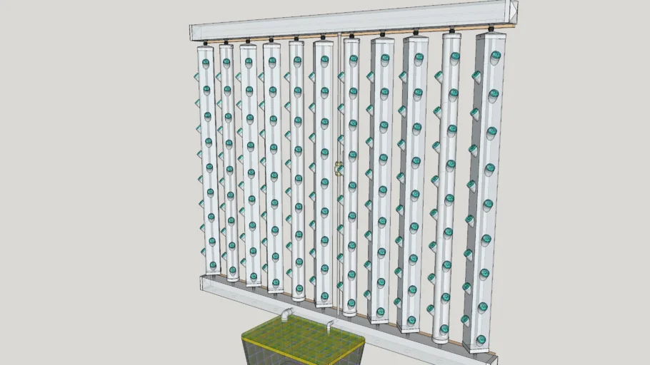

NEWEST: A bit more involved than my others, but way lighter & all the weight pointed down. Might need a bigger pump, once pressurized should be okay @ 650gph. Green/Blue pool noodles. 1/2" supply line. 1" drain. 1/4 drip with pressure regulated emitter, 2gph per plant. Might add a swivel to connect the module to the main supply line (galvanized). Where'd I put my aeroponic potato model?
